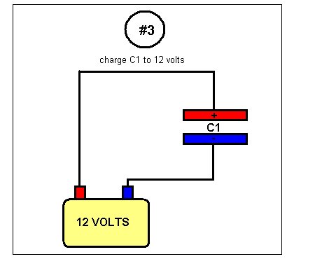

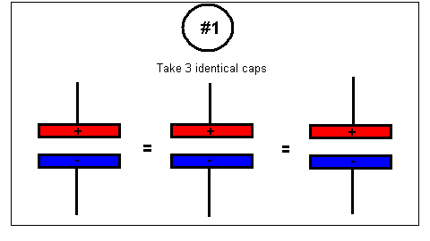

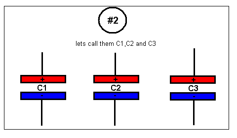

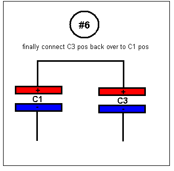

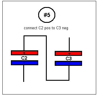

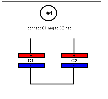

1)Take 3 identical caps 2) lets call them C1,C2 and C3   3)charge C1 to 12 volts 4)connect C1 neg to C2 neg 5) connect C2 pos to C3 neg 6) finally connect C3 pos back over to C1 pos
You will end up with approx. 8 volts in C1 and 4 volts in each C2 and C3  - thats it !
