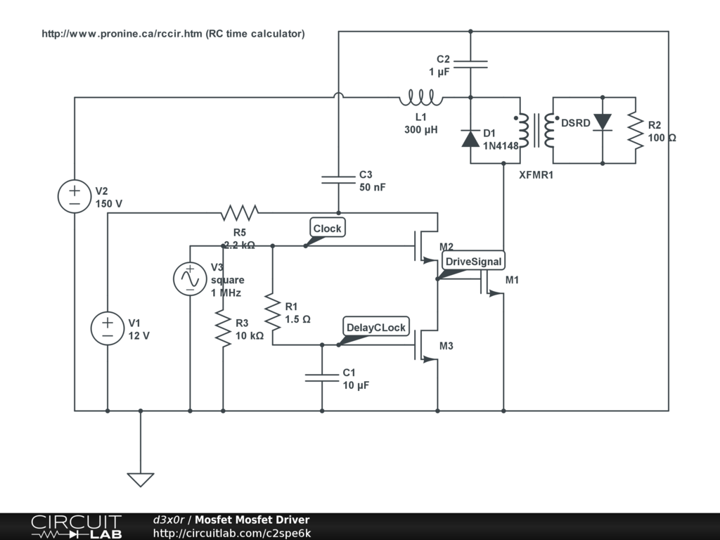

Was working on picking this back up.
I have an alternative circuit for shaping the 150V pulse....  I'm looking for comments/criticisms
The Schematic  (updated, no P Channel)
(Editable link)
the fixed 10ohm resistor should be larger, and paired with a potentiometer to provide width scaling.
can do it with either 2N mosfets to drive the other.
replacement high voltage driver  ... I found this part which has really low on/rise times of 8.4ns/8.0ns respectively, and 18.0ns fall, 4.0 off time.
Instead of MOSFETs I could use bjt's.  I plan to use the a TL494 as the frequency generator, which I can get as low as 200ns pulses.  With the above scheme, it should go on, and latch off, and when the signal drops remain off until the next leading edge, and could even tolerate longer pulses
(The attached image has been updated, it's the link above really; is there a way to embed an external link as an image?)
