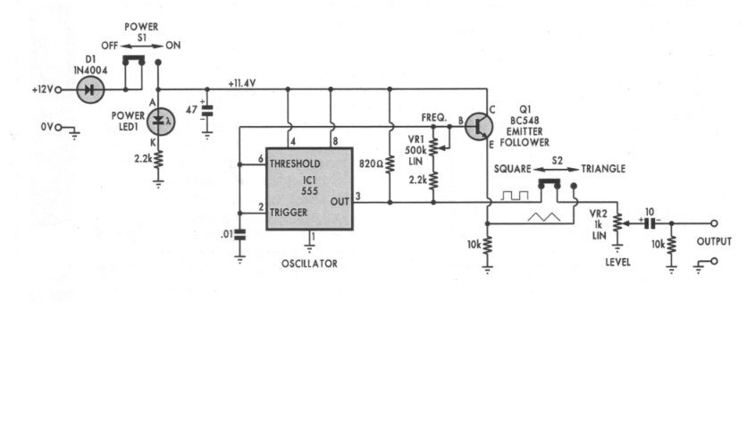

Now here is the untouched schematic for the FG.
As you will see,i only removed the switch and line for the sawtooth wave side of thing's.
So this would in no way change the square wave operation.
The circuit is just a cheapy from jaycar-probably made in china.
But it dose what i wanted it to do for the time being.
poynt99
OK, that FG circuit now makes more sense.
You were right, there was no effect with the parts you removed from the schematic. The sqaure wave output is from the normal pin 3 of the 555.
For the "sawtooth" output, they are simply buffering the timing cap wave form....not very effective, but an interesting and simple idea. It will look like a curved sawtooth, more than a linear one.
