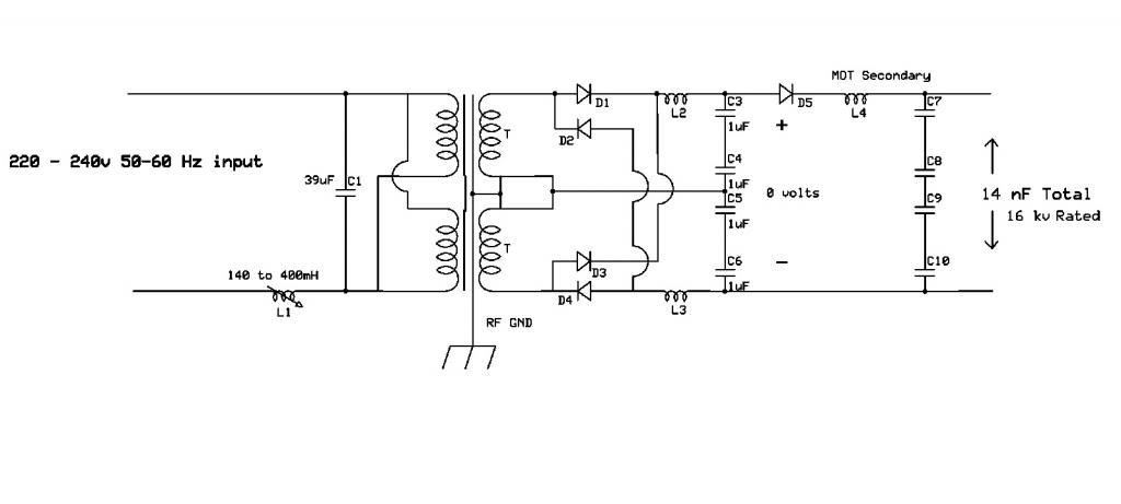

Yeah you can do "secondary side current limiting". See the link. http://www.kronjaeger.com/hv/hv/src/mot/index.html.
The resonant charging circuit does that. http://www.richieburnett.co.uk/dcresist.html
I use a MOT secondary for the charging inductor in my resonant charging circuit. I also have a 400 mH choke made from 0.5 mm wire with removable core in series with the supply,  the two "Supply" MOT primaries are in "anti" parallel then another MOT's secondary is the charging inductor (this MOT can have it's primary shorted to reduce it's inductance). The power is limited to about 650 Watts, current about 2.7 amps in my setup at full power, the HV caps are actually 14 nF, frequency 750 kHz or so.
FWBR means a Full Wave Bridge Rectifier. My circuit uses one but it's drawn in two parts.
Cheers.
P.S. I can calculate my power input by using the electronics assistant program to tell me the energy in the HV caps and multiply by the breaks per second.
Say I dump 8000 volts from a 14 nF cap 500 times a second,  0.448 Joules times 500 = 224 Watts. And it correlates with the energy meter with a bit of losses.
The MOT secondary charging inductor will only allow the supply to charge the caps at a certain rate so the input is limited that way.
Even 6000 volts into a one turn primary with 180 secondary and extra coil turns (combined) would give a transformation to 1 million volts.  ;) Without any resonant rise.
My setup has one primary turn and about 200 turns in the secondary and extra coils combined.
Speaking of "Q" my secondary and extra coils combined have about 3 Ohms resistance and the top load is about 16 or 17 pF I think. And the setup has about 2.5 mH in the secondary and extra coils combined. Almost a Quality factor of 4000.  http://www.circuitsage.com/tools/tool_view&tool_id=17
