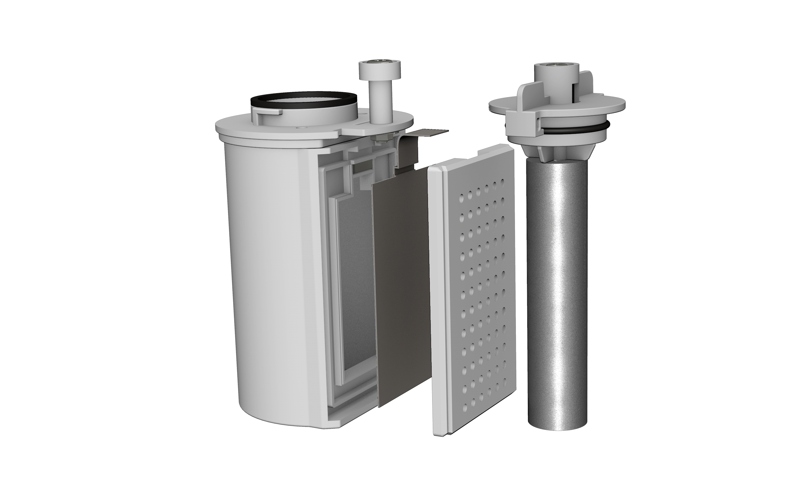

I think this is also an metal-air battery so the graphite plates have to be able to breath air, that is Oxygen...
as Oxygen is needed to be converted at the graphite electrode to go into ions to decompose and magnesium alloy
and to produce current...
So if other persons try to replicate this, make sure your graphite plates are not always under
water or fully inside the electrolyte bath, cause otherwise they can not "breath" air and thus they only can convert the air, that was stored in the graphite matrix, before they were put into the saltwater....
I also always wondered myself earlier, why my saltwater cells became more and more weaker, when I realized
that the graphite electrodes can not breath any air anymore, when they are almpst completely inside the saltwater...
So the best thing would be to put these graphite plates on one side as the wall of the container and with the other side in contact with the electrolyte,
so on the one side they can fully "breath" the air and at the other side are fully immersed into the saltwater electrolyte...
It seems they have exactly done this as you can see here:
http://www.hydra-light.com/#!technology/c24vq
Especially seen in this great picture:
https://static.wixstatic.com/media/4b4cbd_bc14c62da3a5423d9f92d4e3f7e83c26.png
The graphite plate seems to breat air from the other side not beeing in the saltwarer electrolyte...
Well Done Mark Dansie and Team !
Regards, Stefan
Here is still another shot of the cell case:
https://static.wixstatic.com/media/4b4cbd_07d07ccd9e104a3f95bbbc9248c6687d.jpg
where you can see, that the graphite plate will seal the electrolyte container with one of its sides.
I wonder how leakproof is the graphite plate versus the saltwater electrolyte.
The graphite plate must be pressed probably pretty hard against the container, so no saltwater will spill
out... As Graphite plates are sometimes very soft material , I wonder how long these graphite plates
will last in this unit and don´t get clogged by Magnesiumchlorid saltes....I wonder how expensive will
be replacement graphite plates for it..
I also wonder what kind of ohmical resistance these graphite plates will have...
Does Hydra Light manufacture these plates themselve or are they being bought by a third party ?
