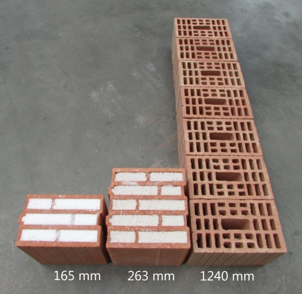

The EMPA Aerobrick ,165 mm, compared with Perlitebrick, 263 mm, alternative :

The given number : 59 mW/ sqm/K  ??? 165 mm brick
Aerogel thermal conductivity : 0,015- 0,018 W/ mv3/K
https://translate.google.com/translate?hl=de&sl=de&tl=en&u=https%3A%2F%2Fm.baulinks.de%2Fbaumaterial%2Flambda-werte-waermeleitzahl-waermeleitfaehigkeit-waermedaemmung.php
0,015 W /mv3 : 0,125 ( for 125 mm aerogel)~ 0,12 W/sqm/K aerobrick wall
and not : 0,059 W/sqm/K wall thermal conduction
