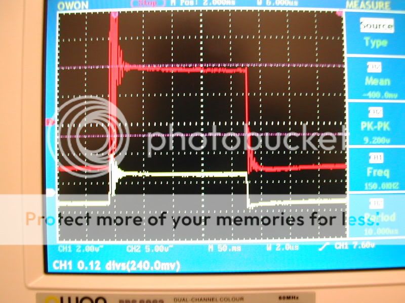

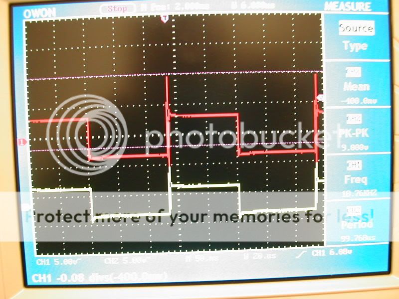

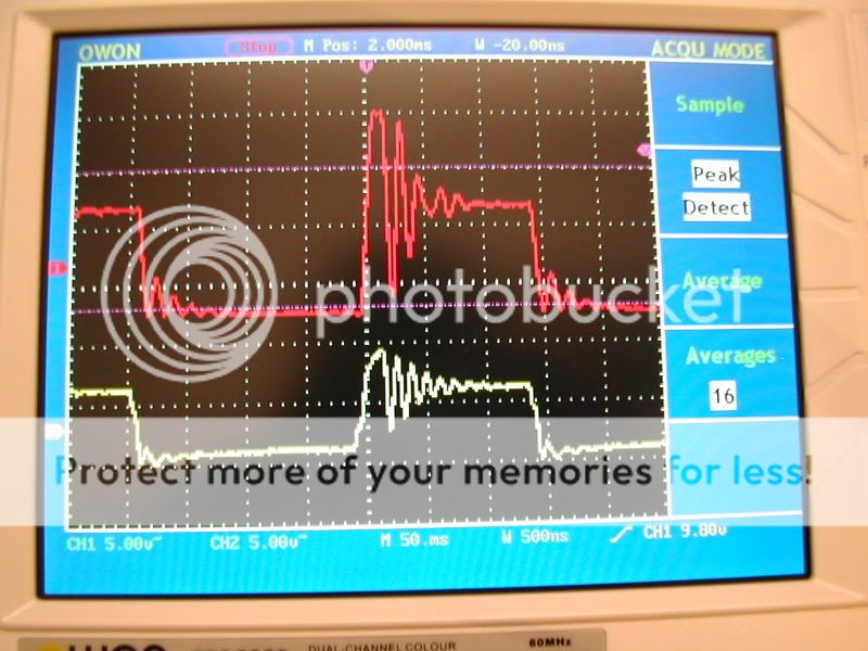

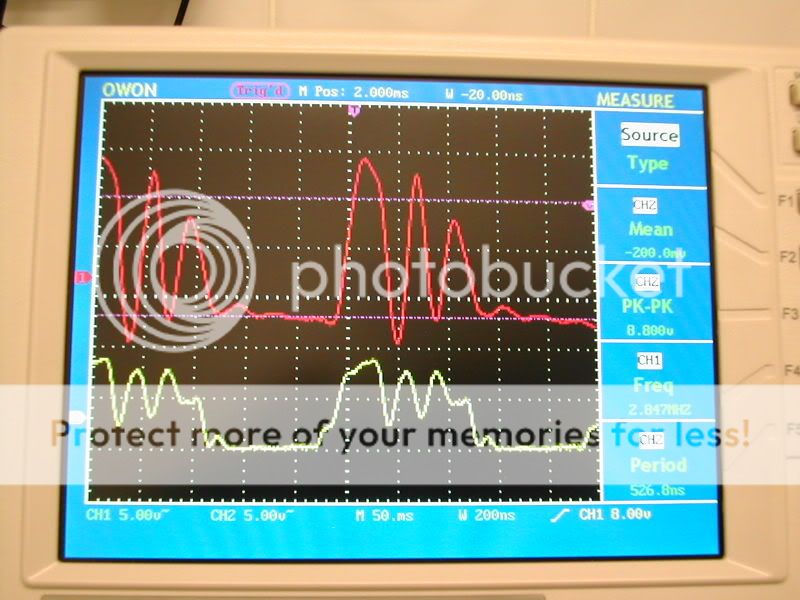

Some testing results for a signal driving a mosfet without the mosfet driver:
6.7 Volts supply to mosfet, 0.6A
Basic setup signal gen. -> IRFU3707Z mosfet (with protection diodes)
1MHz square wave input
300KHz square wave input
50KHz square wave input
10KHz square wave input
What you cannot see is that at 1MHz the mosfet gets very hot and hardly any power get to the light bulb load.
Look how dull the bulb is at 1MHz:
Tomorrow, same test but with mosfet driver.

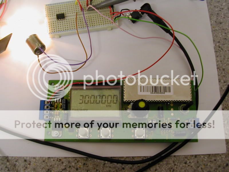

Hi Rob:
What's that cute board you showed eith the freq. reading. is is programmable (sine, square etc) and what resolution and can the frequency (TTL?) be pot. set?
Ideally, what make and model?
Thanks
