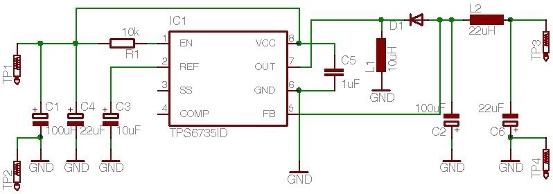

Power on the -12V rail is about 15mA rising to 23.7mA at 11MHz(peak load frequency) with the AD811 output loaded with a short or capacitor. With such low power requirements lends itself to a low power inductor based inverter using the TPS6735 plus the following:
C1 44uF, C2 10uF, C3 1uF, C4 ~44uF, C5 22uF, D1 1N5817 (schottky 1A 20V), L1 10uH, L2 22uH
The whole board will be about 17mm x 43mm and plug into the two 100uF capacitors pads on the DDS 20 board, one capacitor is transfered to the new board.
http://focus.ti.com/lit/ds/symlink/tps6735.pdf
