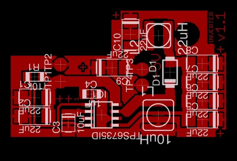

New PCB layout v1.1, not sure if the screw will foul L2 though.
