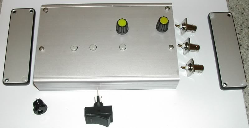

Work on the case for the DDS 20 is progressing slowly.
Several pics showing the progress so far, as this is the first attempt  I have found problems that will be fixed in the next case. Progress through evolution.
Top view, LCD window not cut out yet.
End view shows where I had to cut into the casing to allow the shield to fit up against the front panel.
Rob
