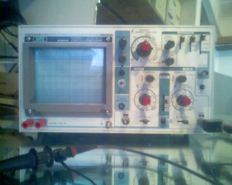

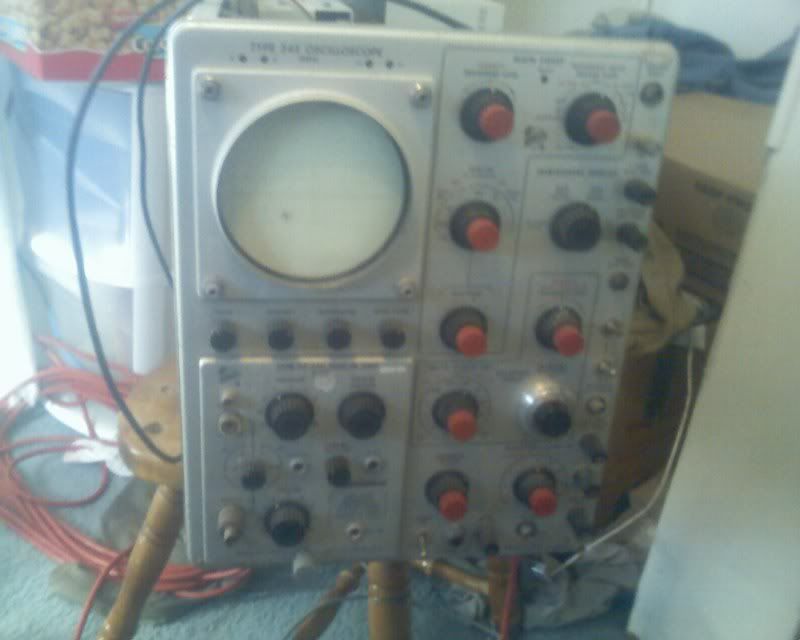

My friend lent me one of his oscilloscopes yesterday. A huge improvement over my of old tektronix tube type O-scope that is so far out of calibration that locking on to a signal is a rare thing.

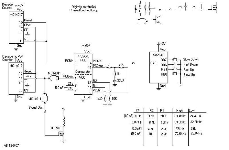

After thinking a lot about how a toroid works I have decided that a Phased Locked Loop would probably not work as I wish it would. The main problem is feed back. If there were only one signal traveling around the toroid there wouldn't be a problem. But there are always two separate currents, one for the powering up of the coil and one for powering down the coil. One signal in and two separate current flows from it.
Here are some pictures.
My old scope:
My friends scope:
The schematic of my PLL:

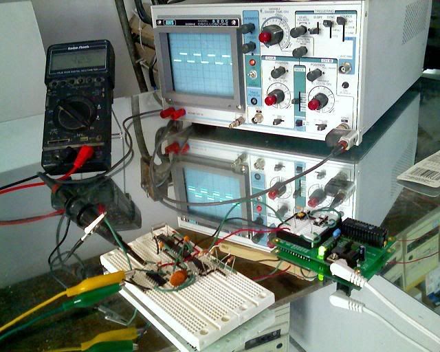

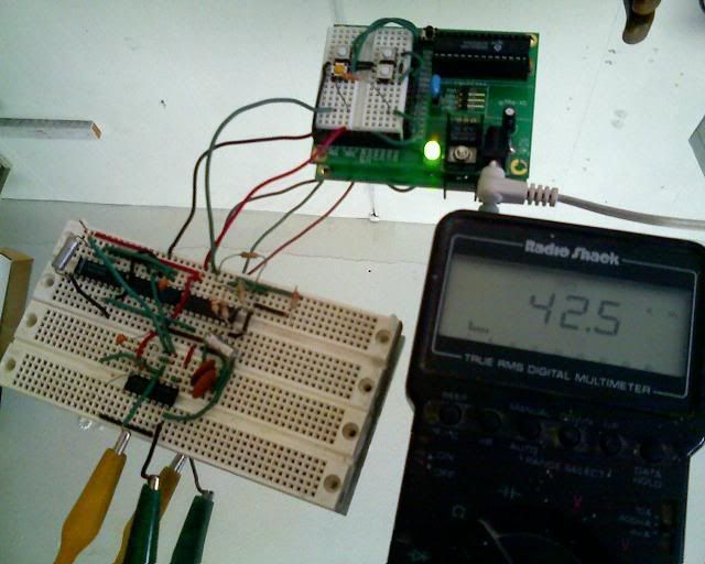

Close up of my circuit:
Nice square wave:
EMdevices
...Phased Locked Loop would probably not work as I wish it would. The main problem is feed back....
LOL,Ã,  you're killing me man.Ã,  :D
Nice work though.  Keep up the good work!!
EM
