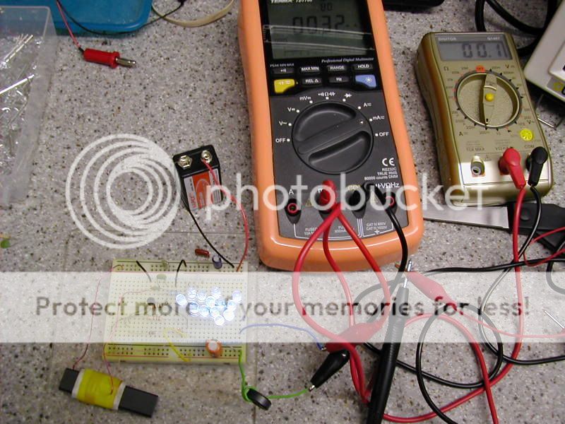

retrod

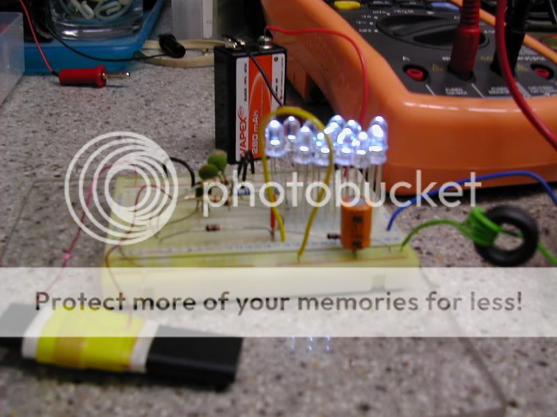

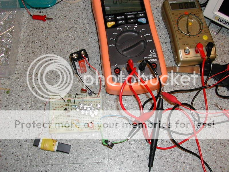

@All,
It works (Thomas Oscillator) but no where near OU yet and I doubt my setup will get there.
Transistor is BC184L with a gain of about 240, circuit seems oscillate at about 12MHz.
Input is 9.2V x 6.2mA = 59mW
Output is 22.4V x 0.82mA = 18.3mW
Output is 8 white LEDs, 3.8V 30mA 13000mcd (I think they are all seconds - bought on ebay from Hong-Kong)
Therefore 32% efficient.
Yes sure, the LEDs look bright, but you can get a white LED to glow at 2.4V and 10uA = 24uW
This is a little different to the max output of 13 candles at 3.8V and 30mA = 114mW
I think I have got dazzled by looking directly into the LEDs ;)
I was able to measure the output by using a 10uF 63V capacitor to supply the LEDs.
It would be interesting to see what results everyone else has achieved by measuring the input/output.
Next step is to try a toroidal core in place of the stick antenna to improve the efficiency.
There is no tuning option with a toroidal core, so I may need to add a tuning cap.
Rob
