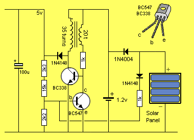

akashh
Hi All,
For those of you who do get 1.1-1.2 volts at low current (5ma or more) - here's how to get it up to 5V.
http://www.talkingelectronics.com/projects/PowerSupply5vSolar/PowerSupply5vSolar.html
It's stolen from another site made to convert a solar cell to 5V for a data logger.
Actually this is maybe more interesting, it explains how to power a pulsed LED garden light from a very small voltage: http://www.talkingelectronics.com/projects/SolarLight/SolarLight.html
