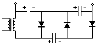

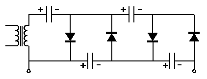

Voltage Multipliers  (these take AC input, output is DC)
Voltage Doubler
Voltage Tripler
Voltage Quadrupler
source: http://hyperphysics.phy-astr.gsu.edu/Hbase/electronic/voldoub.html
Capacitor values are approximate, 10uF is probably about right.  Just make sure the caps are rated for high voltage.
pese
Jes like fynman hve shown it.
use an diode/condensor cascate.
(each step the input voltage will ADDED now to the votage from
last stage before (less the voltag drop in diode (usually 0,7 Si Diode  or 0m4 shottky diode)
for input you must not have transformer.
use anlitte stare-cas oszillator. to drive an small audio-amplifier.
(TDA2002 or others) also from scraped car radio or small home-ampli
PC speakers enz.
The vauel from condensors can be small if used over 1000 Hertz for frequencies.
If using in 100 Hz area you will using in mircro-farad range, (and so giber the
needed currents (power) so bigger the condensors.
air inonizers  using this princip to make from 110 / 22o volt line voltalte  25kW
same you can use at 12 volt by using 10 time more cascades (as at 110v)
the use of stare-case waves , with higer frequencis , will allow, smaller condensors
wit good efficenties.
