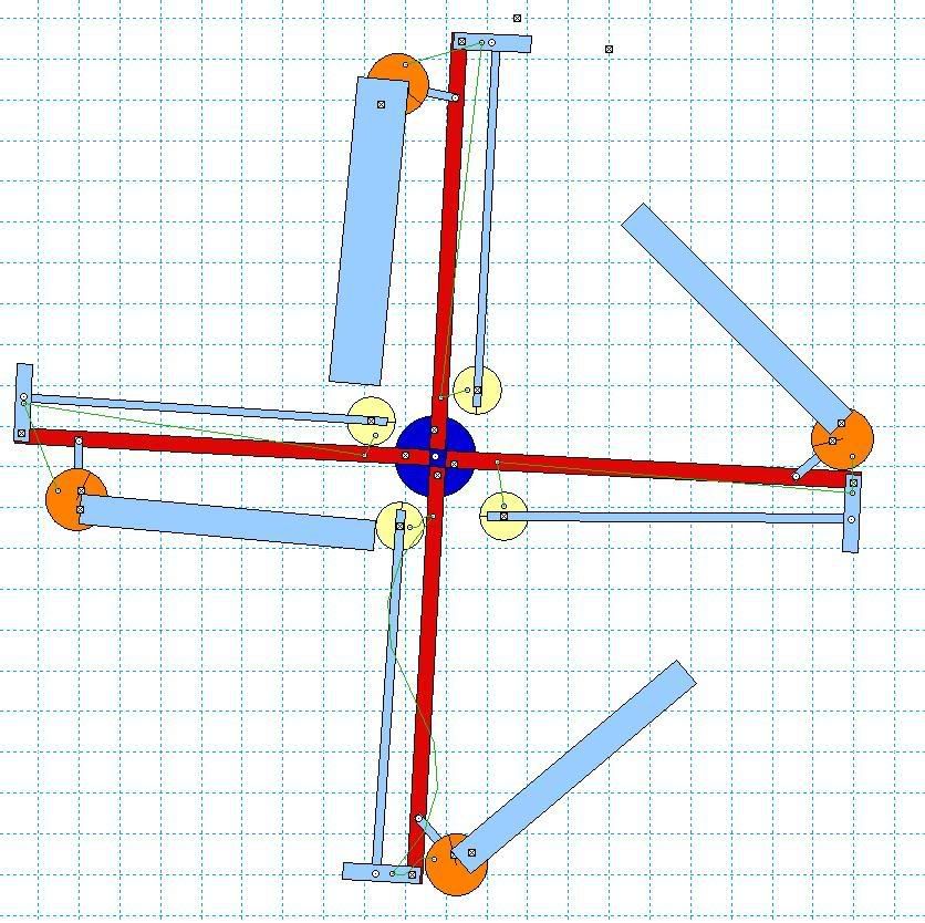

Your MT20 build gives me a weird feeling. I have been playing around with the mass of the weights and what not and it's acting "weird". Basiclly my common sense tells me it should keep on spinning whereas wm2d slows it down. How can something from rest go that far and fast, but after gaining momentum it just slows down...it just doesn't make any sense to me.
hansvonlieven
G'day Broli,
The same thing happens in the flapwheel design. The actual position where it stops is more favourable to rotation than the starting position. Something wrong there, but what?
Hans von Lieven
Yes I believe I see what is wrong now, the inner weight should retract sooner. In the starting phase the south one is already against the frame...while in operation it rests on the frame way to late causing it to halt. I don't know how you guys can get your setups to run so fast and stable. I just added a small thing to your setup and BOOM, it got really slow and unstable. I must have the deadly wm2d touch.
But here's a screen to show what I was going for...
