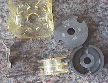

skywatcher
By the way, i think the most optimal core would be a 'pot core' like this:
http://www.oppermann-electronic.de/assets/images/Bild2642.jpg
http://www.jogis-roehrenbude.de/Bastelschule/RIM-Piccolo58-Spulensatz.jpg
Such cores have the lowest losses, are also closed like a toroid, but even more closed  ;) and the coil can be wound very easily because it's a normal coil, you can wind it with a drilling machine in one minute. The magnets can be placed on the outside.
I think i have some pot-cores somewhere, if i find them i will make some experiments...
