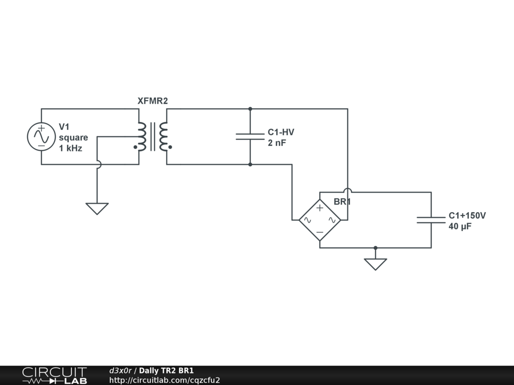

So, need a little more connected.  Want to produce 150V primarily from this, so added a bridge rectifier NTE5322 (25A, 200V, 1.1Vf), with a capacitor on the output.  (Also connected L1, and L2 with a cap, but that just confused the situation, so leave other side open what I thought was L2 ringing wouldn't change when I changed the capacitor, finally disconnecting L1, found I had the SAME ringing).  So, the first ring is between TR2 and the bridge/cap.  If I add a capacitor across the AC input of the bridge, then I can elongate the frequency of the ringing without changing amplitude much.  This helped some, but I still wasn't getting 150V output (very strange, because even a simple joule thief would do that).  Maybe it's the bridge, didn't realize that was so close to tolerance.
I have to take a break here since I have to experiment there; but, when I connected L1 and L2 with a cap to match the frequency I found after adding a cap across the rectifier, the signal was still kind of weak; then I remembered there was supposed to be a ground connection - to L1.  Connecting ground increased the signal in L1/L2 both.   At certain points ground is important.  I guess attaching the ground though ends up making L1 a half wave, a high potential on one side will go directly to ground, having to reason to overcome impedance of the coil, while a high potential on the other side will ... (reversing terms) draw a current from ground through the coil, while the other side will only draw a current from the ground without going through the coil.  This is sort of a half-wave rectification attaching a ground.

A schematic attempt at the above
Okay so ya, 70:3 = 23.4 ratio... so easy 12V * 23 = 246V right? no issue.  Oh, but playing with parameters, maybe my inductance is too low; used to work.
