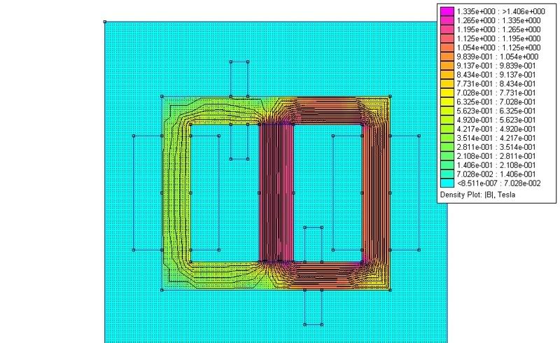

Paul, I think you are right about the input power being just right, according to my FEMM 4.0 simulations, the power needed to get the field to switch was tiny, maybe 10mW on a small core.
5W input on the AMCC-320 I would say was overkill, and should be in the region of say 100mW.
But that is with very small load on the output coils (half the input power I think), the simulation can only go so far with this experiment and I think a practical experiment may see the power input go to 1W.
I have to say I hate this site too, it runs the CPU flat out while the page loads, some crappy javascript running in background, pages sometimes fail, not a nice site...ahh well.
Rob
Meg simulation with 10mA, 0.137 V (1.3mW) in the bottom right input coil.
US Steel Type 2 core and N37 Neodimium magnets.
Core is 120mm wide and 100mm high and 50mm deep.
