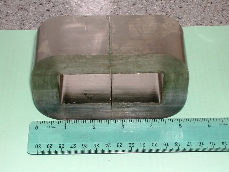

Well the core has arrived, very professional bit of kit.
The ultimate core  "the AMCC-320":
Rob

Great snapshots.  Looking forward to seeing the data. Be careful inserting the PM's as Metglas is very brittle. That's probably another reason for using ceramics, initially.

Quote from: PaulLowrance
QuoteBe careful inserting the PM's as Metglas is very brittle.
Yes, some edge bits are flaking off when you handle it, like chrome slivers.
I am very careful as to how I handle it as I appreciate it is a very fragile device.
