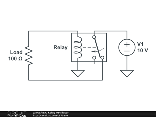

For a single component but not much control, you could also try making a relay oscillator and experiment with that:
https://www.circuitlab.com/circuit/87bane/screenshot/540x405/
hope that helps, have fun ;)
