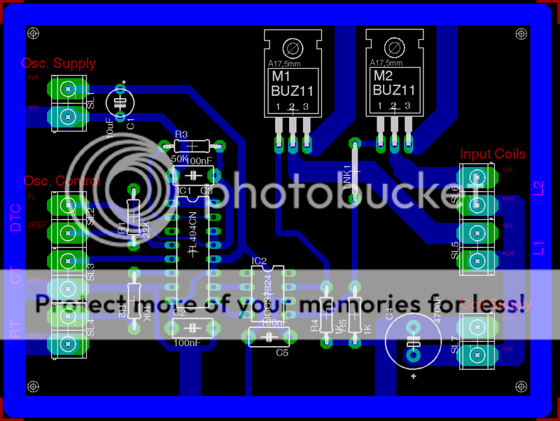

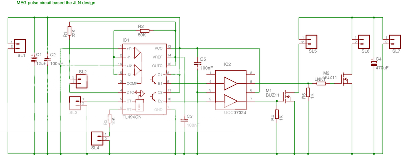

QuoteYes Rob,TL494 is a fine complete device but it isn't good for my purpose as it handles only 42V @ 0,5A (out section) and is slow also, rise time= 100 nsec. - IRFP450 handles 500V @ 14A with rdsON=0,4ohm...risetime= 36 nsec, falltime=35 nsec and is internally protected!!.
Well, of course you would seperate your pulse generator power supply off from your MOSFET power supply - this would seem obvious to me.
Its upper freqency is spec'ed as 300kHz but I found I could crank it up to 600kHz with no problems, is this still too slow?
Yes, I could quote MOSFET specs all day long, but at the end of the day, its mainly what the shape of the pulse looks like on a scope and what voltage will fry it.
QuotePulse charging the cap is an easy way to do the job - a better way would be to use 'ramp charge' but for my test only purpose I think that pulse charge is nice.
Are you saying that pulse or ramp charging is key to getting more energy out than in, or just a way to completely isolate the output mosfet from the power source directly?
This is a circuit I am working on at the moment:
Rob
ronotte
Hi MeggerMan,
and YES I'm trying to obtain both things togheter....I agree with you that MOSFET solution isn't the best but it's easy and cheap (I pajed the IRFP450 only ? 1,25/cad)...but there are driving problems as you have to charge the input capacitance also due to Miller effect...to do so there's need of much input current....if you want to have fast rise time.....so the use of a mosfet driver like IRF7307 or similar are mandatory....you can connect directly to the gate almost every thing but then what you get from the drain is not deterministic.... :D
Your project seems nice but I'm not following the MEG.
