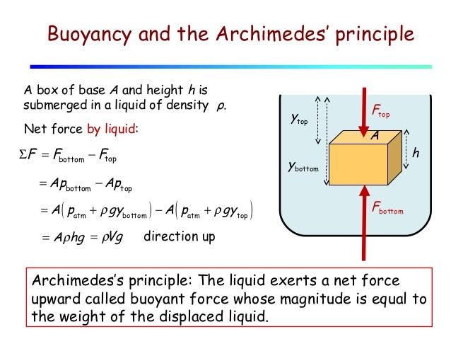

@ Tarsier, nice find. Impressive build. The principle is indeed the same, however I guess it will not work because any 'gain' on one site will be cancelled by an equal 'loss' on the opposite site.
See below for the principle on how I understand buoyancy calculations works.
The question remains if the object in the example given in my earlier post will move up, down or remain stationary, preferably supported by calculations rather then general concepts on buoyancy, water displacement etc.

Quote.... The principle is indeed the same, however I guess it will not work because any 'gain' on one site will be cancelled by an equal 'loss' on the opposite site.
In the video, his motor runs in the wrong direction. The larger surface area on the tubes should be rising, not falling. There used to be a video of this device test running in water.
Explain to me the "equal loss"? as it relates to your principle.
Your Buoyancy calculations match this I think:
Also, if we use your buoyancy calculations on the device in the video, won't it work?
