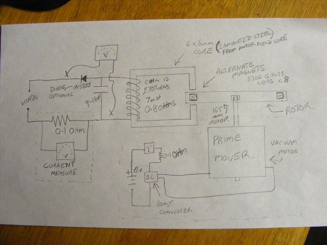

Hi all, Here is a drawing showing the setup I used.
And here is a couple of clips the first one explains the setup a bit.
http://www.youtube.com/watch?v=W2NfmyyhbZs
The second one shows some of the effects I got.
http://www.youtube.com/watch?v=TV_dm8COKBY
Cheers
