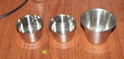

Here is picture of cups, beside Walmart cup
They are rather small at 25ml, however seller has larger (50ml, etc.) I haven't had time to do anything with these, I am going on a 3000+ mile roadtrip, and will be testing my current HHO generator (6 Walmart cups) and my new one below.

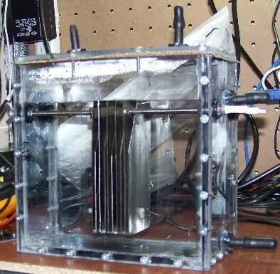

Here is my latest build, with 10 stainless plates. I have tried here in Canada to get 316L stainless, but unless I want an entire 4'x8' sheet, or am willing to pay hundreds of dollars, I haven't been able to purchase any. I may have to break down and buy some off eBay.
This is built using 10 stainless steel wallplates (buy these at an electrical wholesaler - I paid 99 cents each VS $2.50 each at Home Depot) - used a "dead blow" hammer to flatten them, cutoff saw to cut the corners, cobalt bit to drill the holes. They are suspended on threaded stainless rods, which are also the + and - feeds. Plates are connected together with nylon bolt through top and bottom holes, with a rubber plumbing washer between each plate as a spacer. Box is 6mm lexan, which is nice to work with but should actually be thicker. It is nice stuff because you can drill holes and tap them, and just thread your fittings right in.
