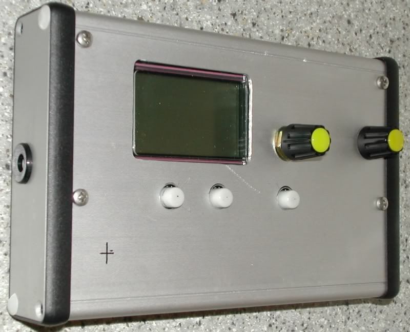

Photo showing DC socket in place.
Also have the LED on/off rocker switch in now, just the BNC sockets to go.

Hi Bruce,
It's not brilliant,some of the holes were out by about 1mm, I cut the window for the LCD larger than needed because I took a chunk out when the router was slowing down and decided to cut I nice curve into the side. Should have held it firm until the router had stopped.  (mental note: get workshop assistant).
The rocker switch is very large for the case size and I will mount the next one on the side next to the DC socket.
I scratched the anodized case a few times during drilling - swarf under the workpiece. I got around this after the event by covering it with pvc tape.
The good news is the 3mm foam stuck on the inside pushes the LCD module onto the board and clears up the missing segment problem.
@Ward,
Its taken a few hours to make this one, but it is a prototype and I am getting some special milling drills for cutting the larger holes in the case.
The routing of the LCD window took about 10 minutes, so I am pleased with that. The next one will be a bit neater.
BNC sockets;
1. Square wave
2. Sine wave
3. Programmable pulse width square wave
I have not built the circuit for the last output yet, but this will be to drive the DS1023-100 chip using a PIC to give a pulse from 3ns to about 255ns(I think) in 1ns steps.
Also I will be doing some artwork to print onto tech sheet via laser printer and glue to the case to provide legends for the controls.
I have 4 cases to drill/mill and mark up for you.
I will be leaving the black trim off because it fouls the screws, but more important it is too close the sine wave amplitude control.
Rob King
