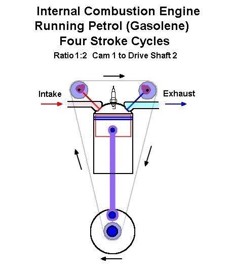

Here's an animation I am working on for the final compare...
First here is the 4 stroke engine, the regular one in cars these days, which normally runs gasoline/petroleum (gas/petrol).
Notice it has a 1 to 2 (1:2) ratio for the cams rotations to the crankshaft.
4 Cycles (strokes)
1. Intake
Starting at the top (Top Dead Centre (TDC)) the piston starts towards the bottom, with the intake valve opening, and letting the fuel/air mixture in, the piston act like a pump it sucks in the fuel. The valve closes according to design, usually before the bottom (Bottom Dead Center (BDC)).
2.Compression
The cyclinder is now sealed, and starts to go from BDC towards TDC and compresses the fuel/air mixture.
3. Firing
Just before TDC the spark plug fires, usually a few degrees before TDC, and ignites the fuel/air mixture. The intertia of the flywheel keeps the crankshaft spinning, along with the delay in igniting the fuel and it's burn rate, and gets past TDC before the full expansion occurs, which then drives the piston downwards towards BDC.
4. Exhaust
After BDC the expansion having finished, the piston starts to rise up toward TDC again, and starts to compress the burn up gases (Carbon Monoxide (CO2)) and then it opens the exhaust valve, and the CO2 is released under pressure, as well as with the pumping effect of the piston, pushing it out the exhaust port. The valve closes just prior to TDC ready to take in more fuel/air mixture and the cycle starts all over again.
To maintain an idle speed, it is usually around 250 to 850 RPM (Revolutions Per Minute) Depending on the number of cyclinders. More cyclinders requires less speed to maintain idle speed. Any lower and the engine stalls from not being able to maintain the cycle. Redline (Max Speed) is around 5000 to 6000 RPM, with variations due to make etc. Motorcylces like 250cc usually idle between 1000 to 1250 RPM and often redline at 9,000 to 12,000 RPM. V8 cars often redline at 4500. Though most of these figures are 20 years old and from memory.
Heres the animation...
Note the cams here are showing only 4 positions and would normally rotate smoothly.
Heres a faster animation which hides the pulses better with the illusion of animation.
(motion pictures are really still images at 25 to 30 frames per second. ;)
Note that fuel burns at a set rate, so the faster the RPM, the sooner the fuel needs to be ignited. This is called ignition advance. These days they are electronic, in the old days they used points switches on a cam, which would then have weights which would spin outwards to a maximu distance with some variation, moving the points cam (not shown) to advance from typically 4 Degrees BTC (standard) to the fully advanced setting of around 25 Deg BTC. Some even much more.
With HHO additive to standard fuels, as there is much about on the net and in here. The petrol gasoline then burns faster, burning more fuel, making it more efficient. For unburnt fuel ends up in the exhaust pipe, showing a black soot on the plugs coloration.
Note the cam chain is also shown here. Which also requires the cams set for best timing. The lobes on the cam effecting how long the valves are open and closed. Hence high performance cams get more power again. There is always a balance between fuel enconomy and power. HHO gives more power as an additive.

Everything I read about HHO Brown's Gas, said that if you ignite in a sealed cylinder, it implodes.
It MUST be SEALED. Mixing it with petrol, is not the same thing. And igniting it with any air inlet is not the same thing. It was over 20 years ago I read this, but the idea stuck in my mind as an amazing thing. It might be possible they said it had to be in a partial vaccum already. IE as when a cyclinder is opened and sucking in the mixture as in the animation above, and the valved closed Before BDC. The mixture is then in a sealed chamber, and the piston still heading towards BDC makes it partial vacuum, certainly less than atmospheric pressure. If ignited at BDC it now is a completely different set of circumstances and then it wil SUCK the piston upwards. That is the ONLY reason I am mentioning this whole article is based on that article interview with Dr Yul Brown in the 80's with Grass Roots magazine, which was based on alternative ways and energies.
Do you know for a fact that it explodes in this case?
1. In a sealed container with a partial vaccum?
2. Ignited near BDC
Note the above diagram animation is a standard 4 stroke engine running petrol firing regular Before TDC.
I have yet to do another animation with HHO Brown's Gas firing near BDC (Bottom Dead Centre).
