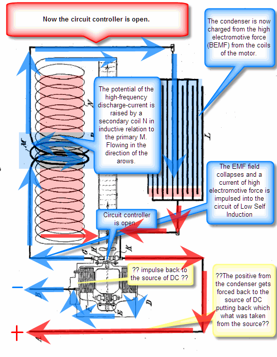

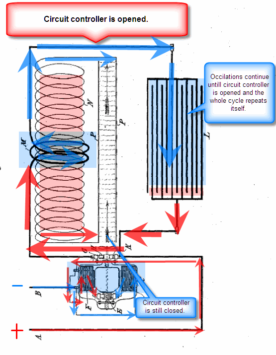

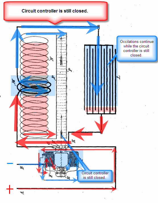

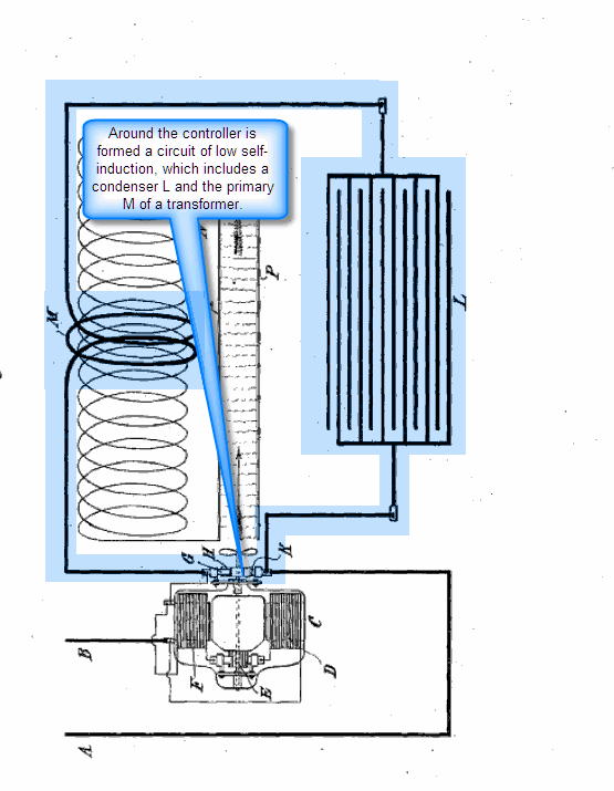

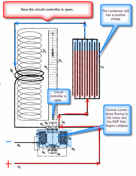

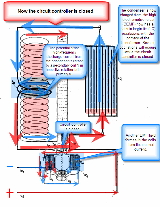

am1ll3r
Also standing out on the limb... This will probally need some correcting but have a look.
The genius of this circuit is the gain in from the occilations that are formed simply by turning it off. (Make and break of the circuit controller).
So far this is my understanding of it...
